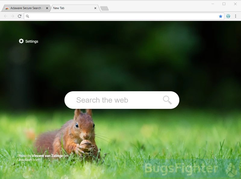

    How to remove Ad-Aware Secure Search - BugsFighter
    Tutorial that will help you to remove Ad-Aware Secure Search from Google Chrome, Mozilla Firefox, Internet Explorer and restore browser settings.
    www.bugsfighter.com
